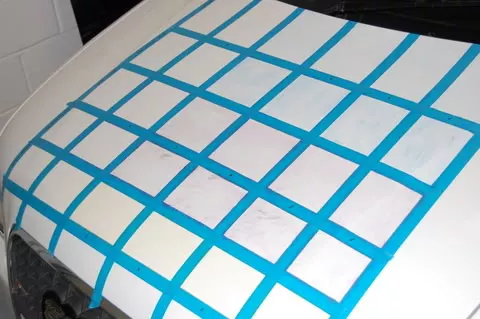

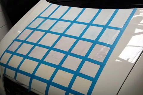

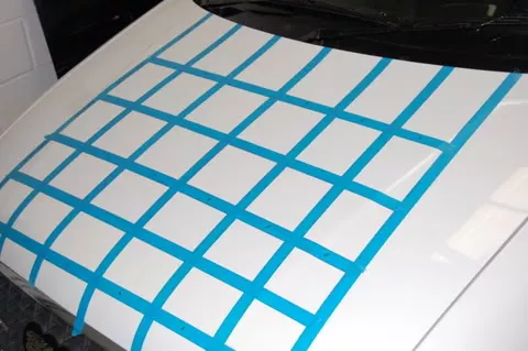

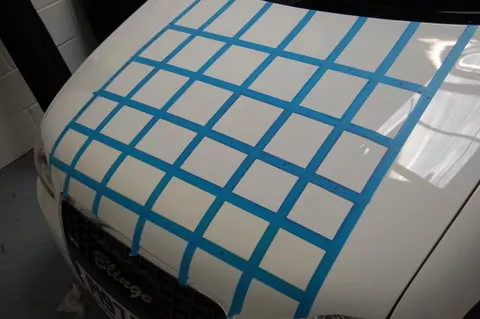

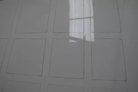

I therefore prepared the white bonnet of our van and divided it into 30 panels. We would apply ever increasing layers of Blue Velvet, Blue Velvet Pro, Purple Haze, Purple Haze Pro and Orange Crush (we ran out of bonnet otherwise I'd have done more) over a couple of days and see the results.
The waxes were all finger applied and at least an hour was left between buffing/layers. The long cure would not be possible on a black bonnet on a hot day, but it was applied in average temps in our unit on a white panel, so there were no problems. An hour ensured all waxes had cured (the Pro waxes may take longer).

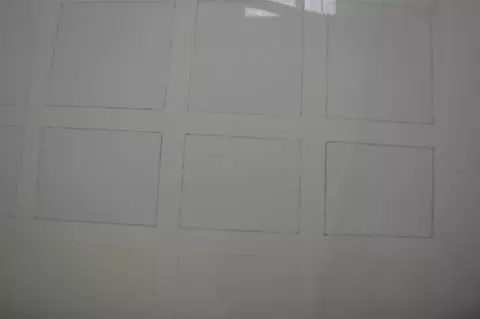

Here they are after fresh application (unbuffed):

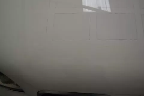

Don't get too excited, they buffed down to this:

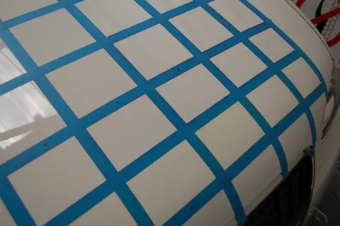

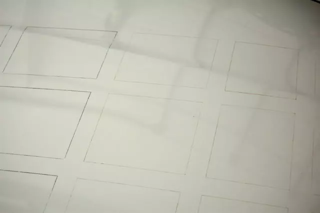

Here it is with another layer of wax on the multiple layer panels:

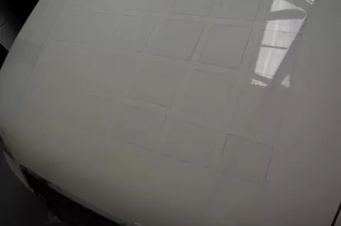

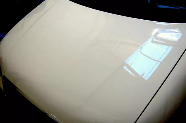

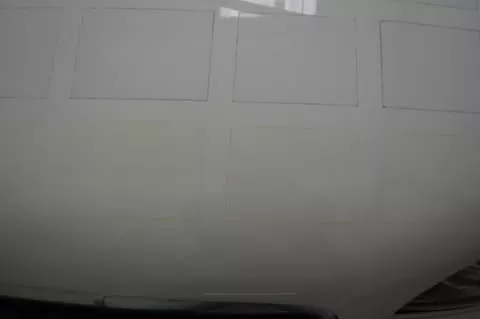

And here it is after all layers, from one layer to the left, to six layers on the right, have been applied and buffed:
Not exactly a respray by any means, but the wax colours are subtly visible. Orange Crush and Purple Haze Pro appeared the most visible at this point:
Now, I should point out here that NO FANCY CAMERAWORK OR PHOTO MANIPULATION are taking place. I have uploaded original and unedited pics to photobucket and I'm happy to send an original to anyone who wants to verify this. The camera is a D40 on whatever setting it chooses, and the only change was leaving the flash off because it 'blinded' the shot. Natural daylight from the skylight was used. I am not clever enough or patient enough to play around with cameras to create effects I want to convey, but I have edited a pic at the end in Picasa AND SHOWN THE LEVELS so you can see the effect more clearly and saw what I adjusted over the original pic.

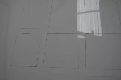

OK, unmanipulated pic with the tape off (the strong blue tape made Blue Velvet seem very feint).

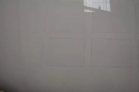

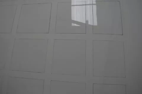

And now, natural shots, panel by panel, layer by layer:
Blue Velvet 1 layer, 2 layers, 3 layers - too blurred, photo not uploaded (I got better with the rest of them... the camera wasn't focusing well so I had to use manual not auto focus on these close ups)
Blue Velvet 4 layers, 5 layers, 6 layers
Blue Velvet Pro 1 layer, 2 layers, 3 layers
Blue Velvet Pro 4 layers, 5 layers, 6 layers - notice how the residue has built up by the tape with these thicker layers
Purple Haze 1 layer, 2 layers, 3 layers
Purple Haze 4 layers, 5 layers, 6 layers
Purple Haze Pro 1 layer, 2 layers, 3 layers
Purple Haze Pro 4 layers, 5 layers, 6 layers
Orange Crush 1 layer, 2 layers, 3 layers
Orange Crush 4 layers, 5 layers, 6 layers

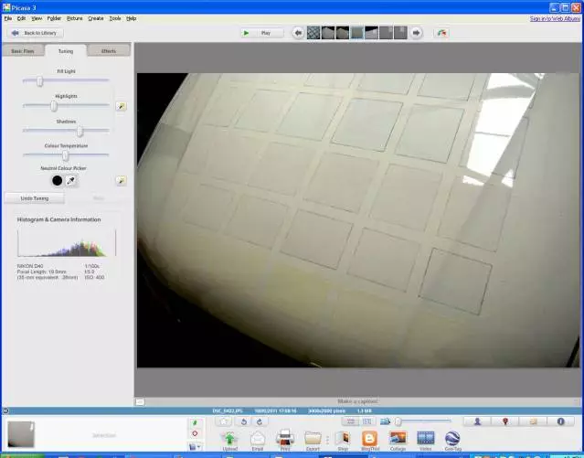

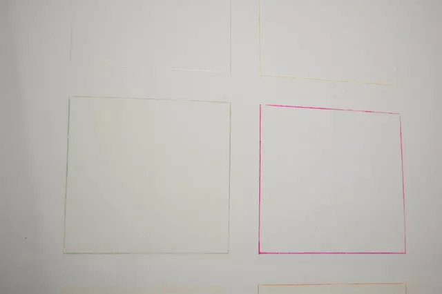

And now the money shot, which HAS BEEN EDITED to increase the contrast so any changes to the colour of the paint by the wax can clearly be seen:
CONCLUSIONS
1. It is clear that coloured waxes of a certain type CAN and DO affect the colour of a paint. Whether this is largely due to the coloured oils/dyes or other ingredients is unknown, but I would guess it is mostly the oils.
2. It is obviously a subtle effect. Purple Haze Pro and Orange Crush seemed particularly strong in my tests. Whether you see it on darker coloured paint than white would be debatable, but the oils are there. You cannot physically magic them away by cynically thinking they do 'absolutely nothing'. The absolutely do something but it is something subtle and unnoticed on most occasions. You need a test like this to make it obvious!
3. The fourth layer seemed to have the strongest coloration. This would suggest that you can layer these waxes four times before you start taking old wax off with the fresh layer, or buffing it down to a 'maximum' level. However, it may be that the oils are simply being absorbed by the old wax layers underneath and thus getting darker each time (with the wax remaining at an even level), although the colour shouldn't fall back on subsequent layers if this was the case. Although highly subjective, it would be enough for me to question the 'two layers is maximum' theory. It may vary from product to product, and in these tests, four layers seemed to be optimum. We would still recommend at least two for coverage, and no more because it would be largely unnecessary for the effect or result that needs to be attained. But don't scoff if people layer waxes more than twice. I won't after seeing the panel here.
4. We aren't going to be bringing out a whole rainbow of coloured waxes for every coloured car, although colour and fragrance feature prominently in our range and always will. But let the cynics be assured, those who think layering a coloured residue on a car has absolutely 'no effect whatsoever' are incorrect in their assumption. It does have an effect, although it is a slight and possible unnoticeable one in real terms. If they need to, they can pop over to Bishops Stortford and see the bonnet. Indeed, Nathan from Cambridge Autogleam happened to be passing and saw the subtle results for himself. This test will be readily replicated on a white car with the waxes used, given reasonable prep and application/curing.
5. You can still use any colour wax on any colour car. A white car will not turn deep blue with a layer or two of Blue Velvet on it. But if you want your white car to stay purest white, don't put four coats of Orange Crush on it.
6. Always judge a wax on what it does FOR YOU. If you like it, or can 'see something' then happy days. If you have layered it 25 times and don't notice any difference, then please don't buy it again. Flake pop, hue, reflections... all may be altered by every product, coloured or not, added to the car. Even a shampoo with an unwitting amount of silicone in could darken paint. But don't believe all you read on the forums, or assumptions made by 'experts'. Get out there and test it yourself.
