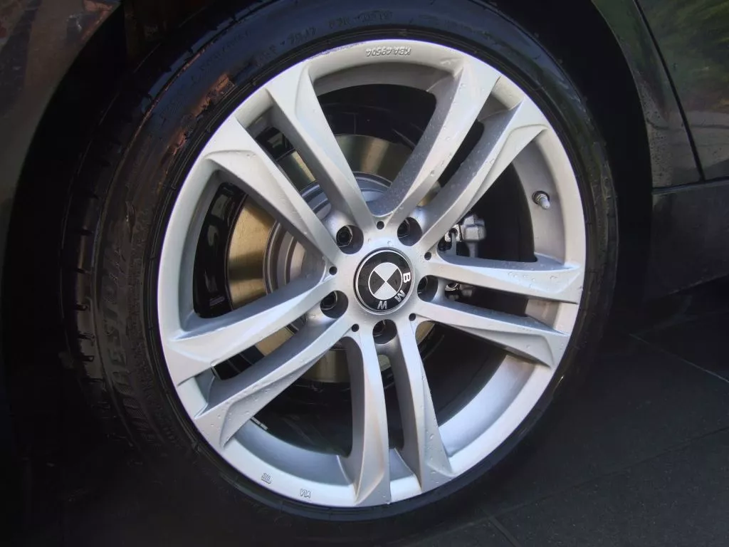

Started off with the wheels.

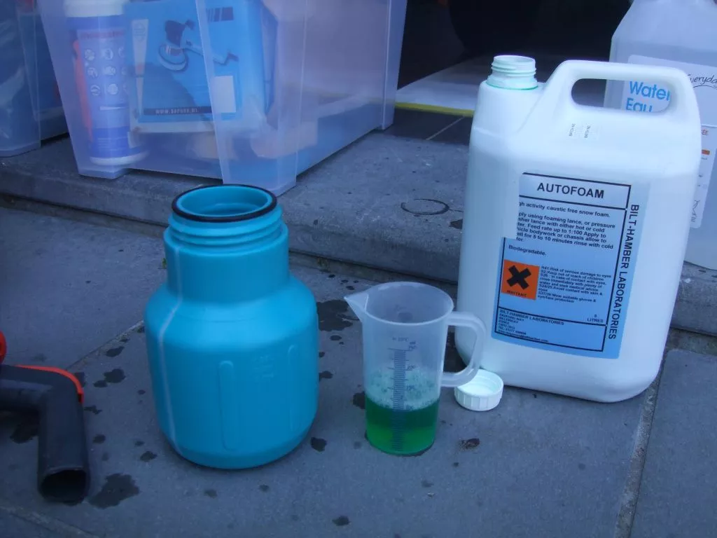

Hit them with an 8% solution of Bilt Hamber Auto-Foam through a pump sprayer and pressure washed off.
Came up pretty clean already!

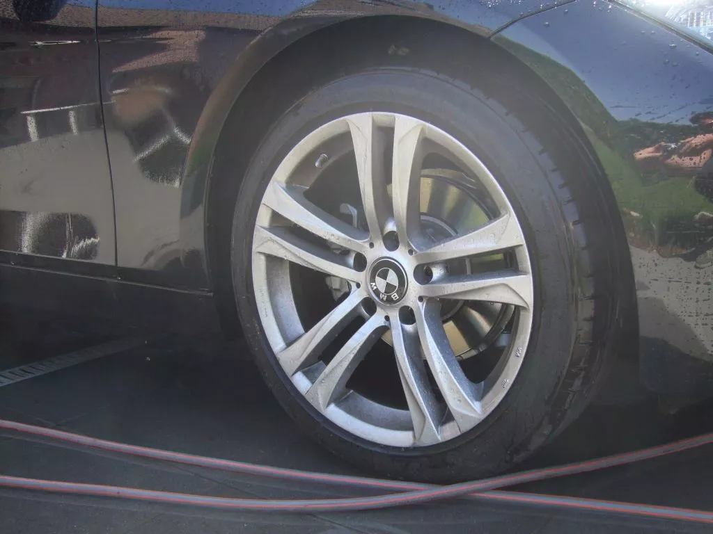

Next was to tackle them with Autosmart Smart Wheels (1:8) and different brushes.
Finished!

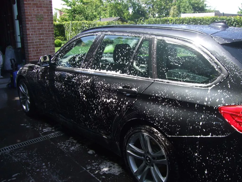

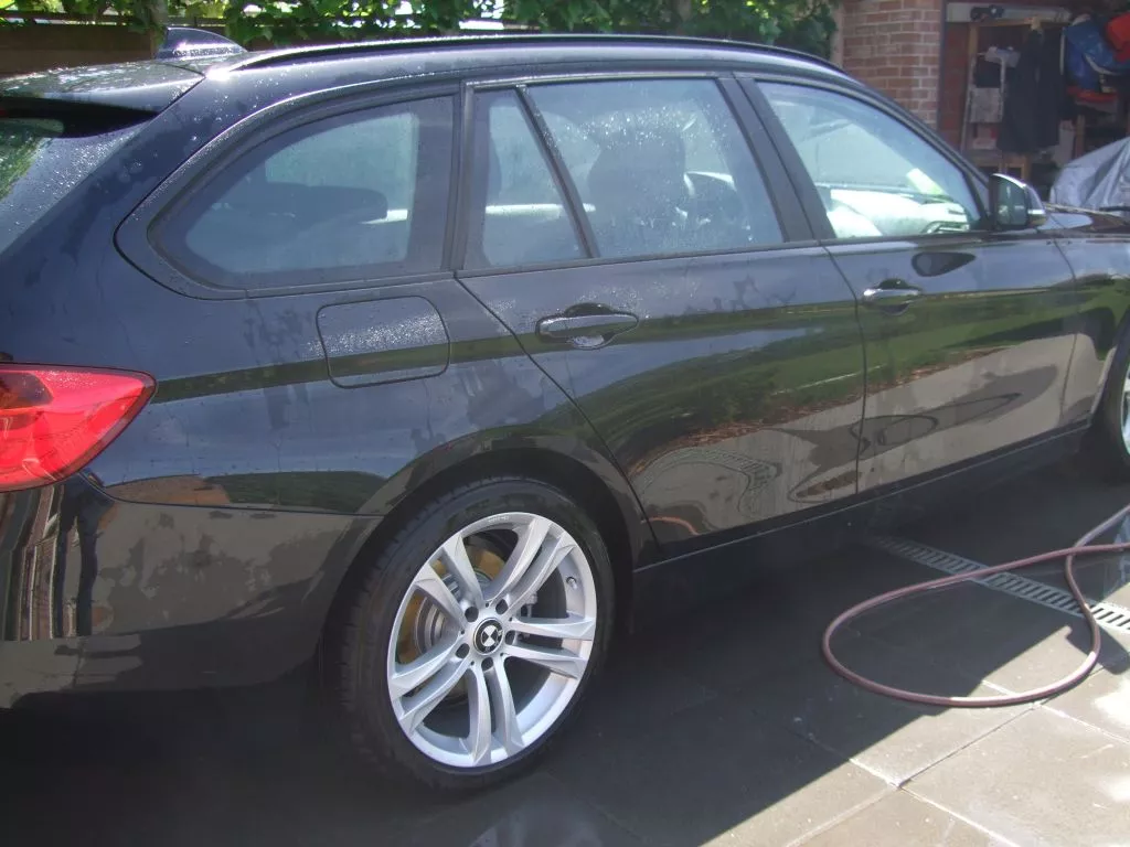

Next up was the bodywork. Had been a couple of weeks since its last clean.
Again some Auto-Foam 8% solution through the sprayer.
Though not foaming up as well as other products (when using with a foamlance) this product's cleaning abilities are unmatched!

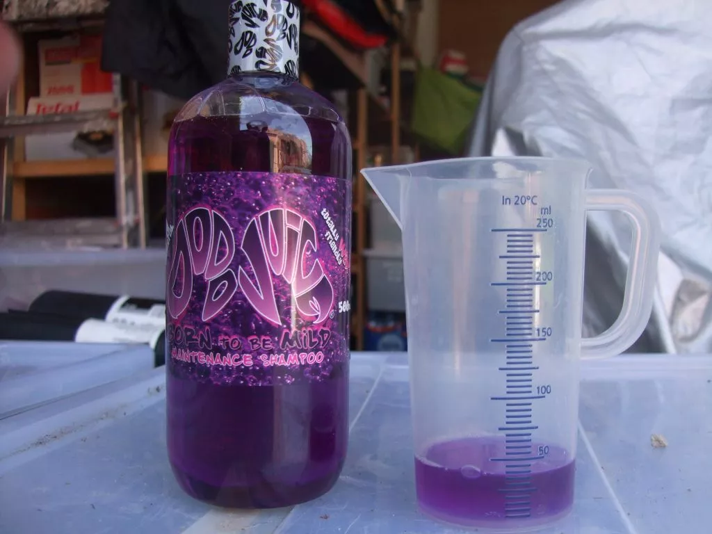

Next up was something new for me: Dodo Juice Born To Be Mild.
Diluted about 1:400. Gave some great suds and really satisfied with the cleaning power.

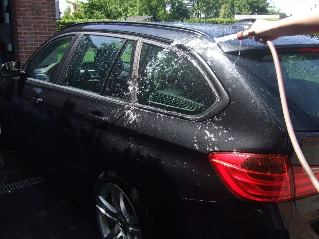

Hit with a little BSD as a drying aid and to add some protection. Pressure washed off and then a hosedown.

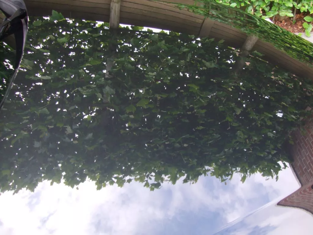

Sadly, as the sun was out yesterday, I was left with quite some watermarks.
Had ordered some Dodo Juice Basics Of Bling Detailer Spray and gave it a try. Got rid of most of the marks, but the most stubborn were still there :(.
Found the detailer spray left some streaks as well. Used it diluted 1:10 with distilled water. Any tips? Found my last detailer spray to be way easier - Meg's Last Touch - though this I use at a 1:1 dilution.

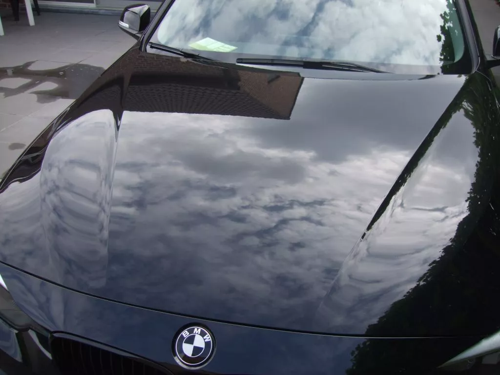

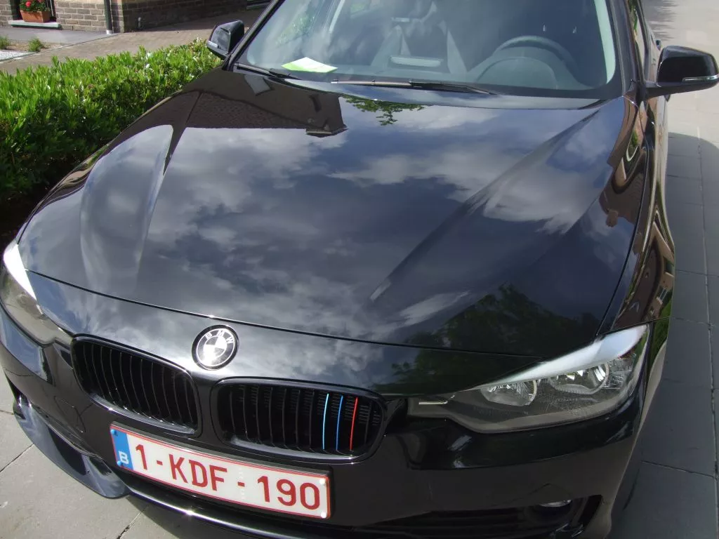

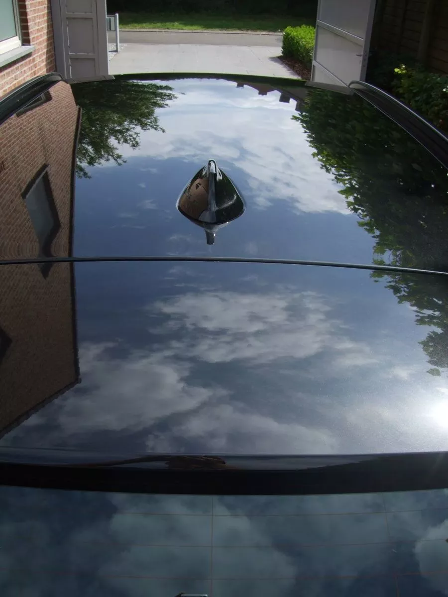

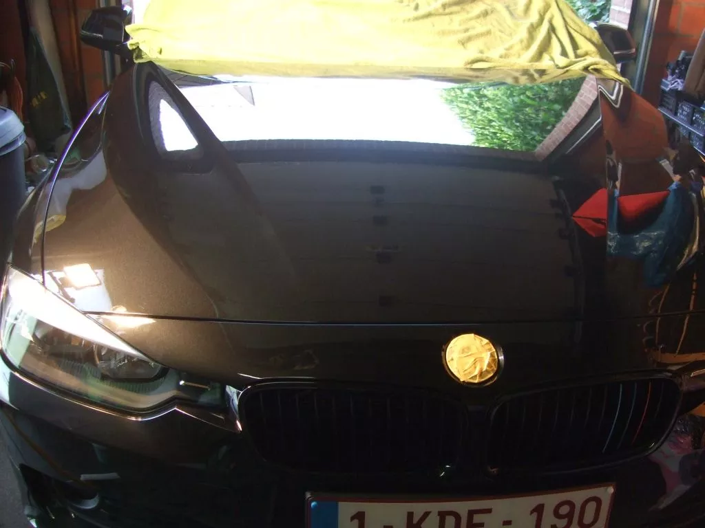

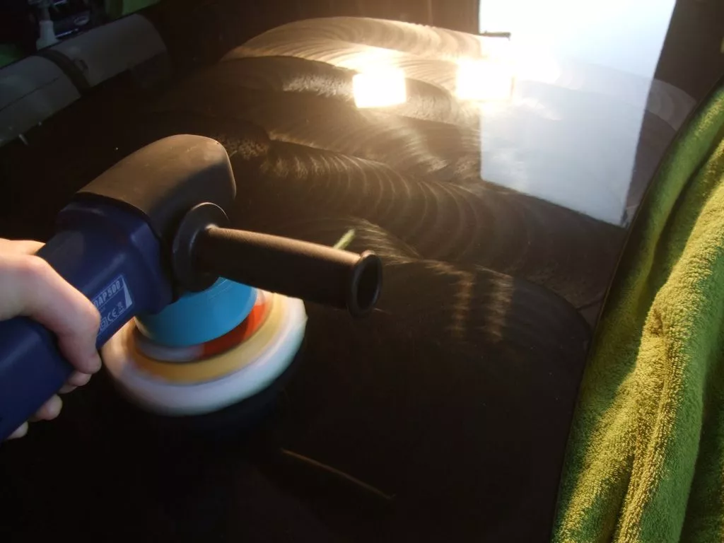

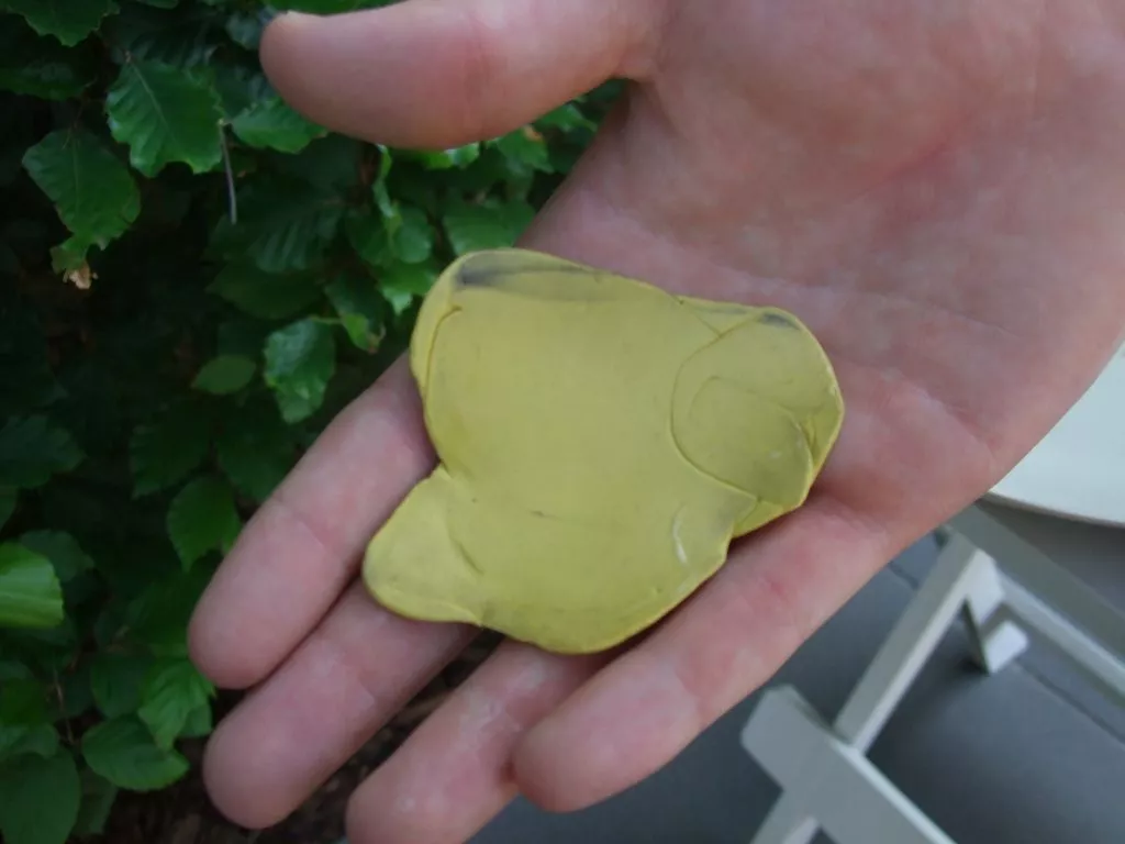

Decided to clay the bonnet and roof and gave them a go with some Meg's 205 on a white Hexlogic. This removed all the water spots.

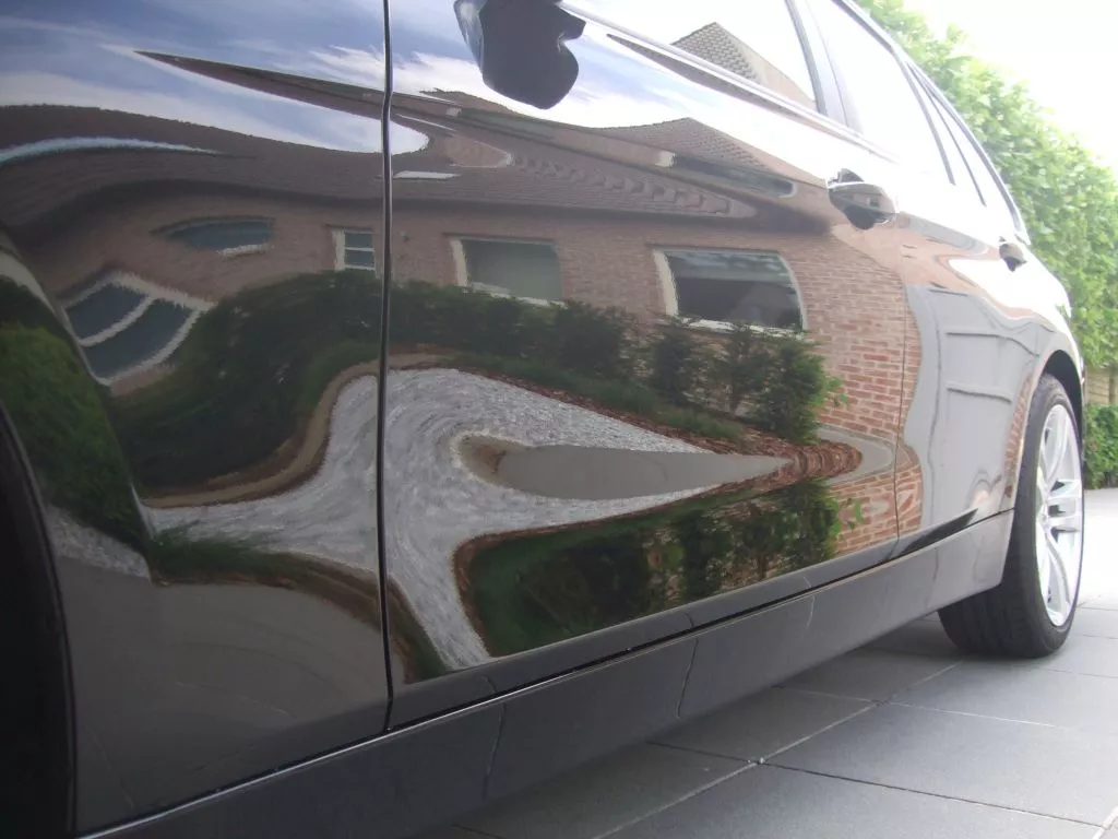

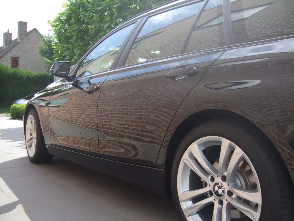

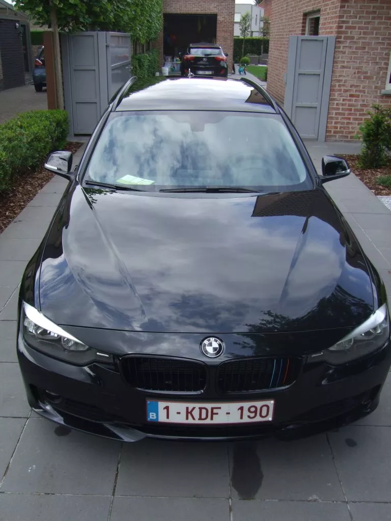

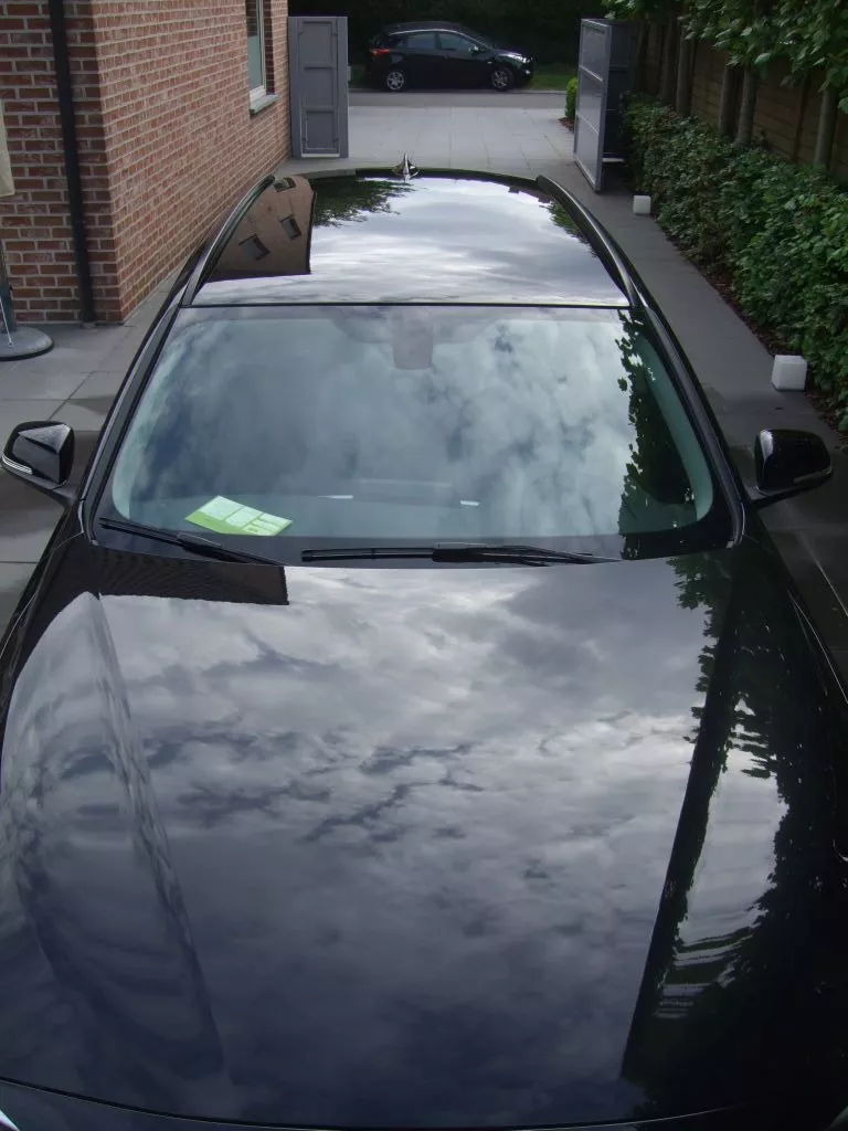

This morning I gave the car a quick wash before applying a layer of Bilt Hamber Finis Wax. Found it easy to apply and hope it will give the results I'm hoping for (minimum 4 - 6 months?).
Buffed off to a high gloss finish.
And then the afters. Enjoy!
