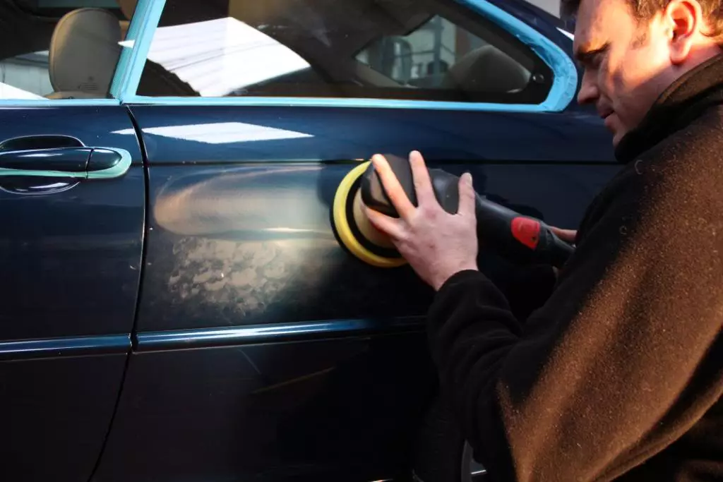

OK, we start with some dark, swirly, BMW paint.

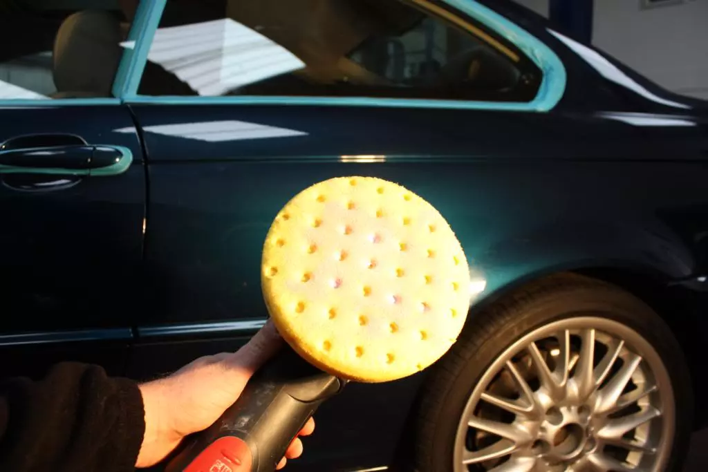

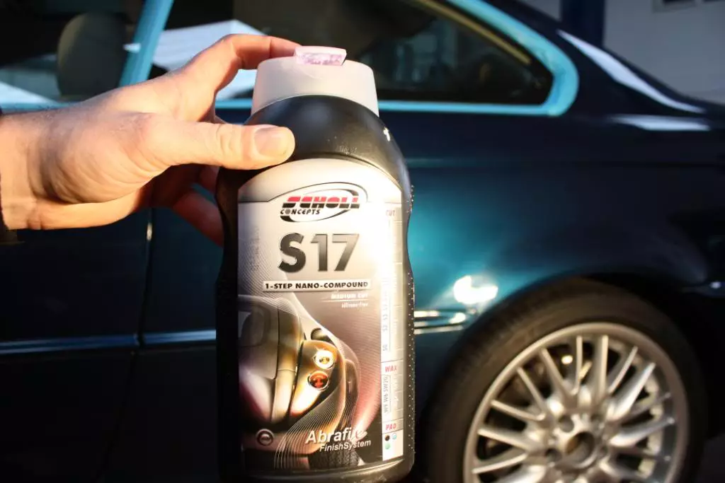

This gets machined with a 'silicone-free' medium-heavy cut compound (according to manufacturer info). Being silicone free you may expect it to fill less as silicone oils and resins tend to be very good fillers.

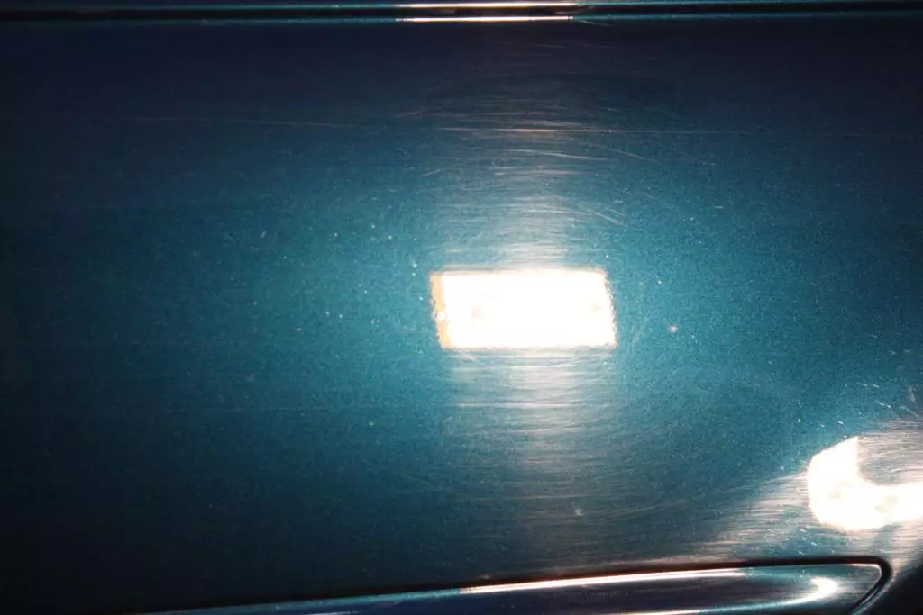

A slightly hologrammed finish is achieved, perhaps to be expected considering the relative aggression of the cut promised by the product, the pad used and the claimed lack of silicone...

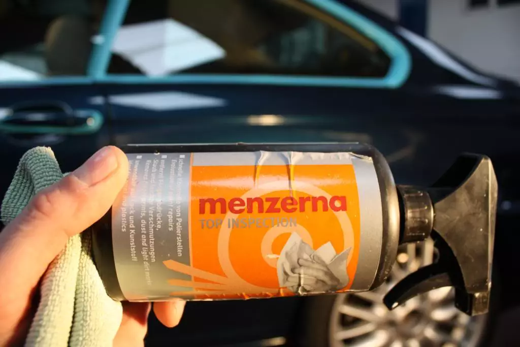

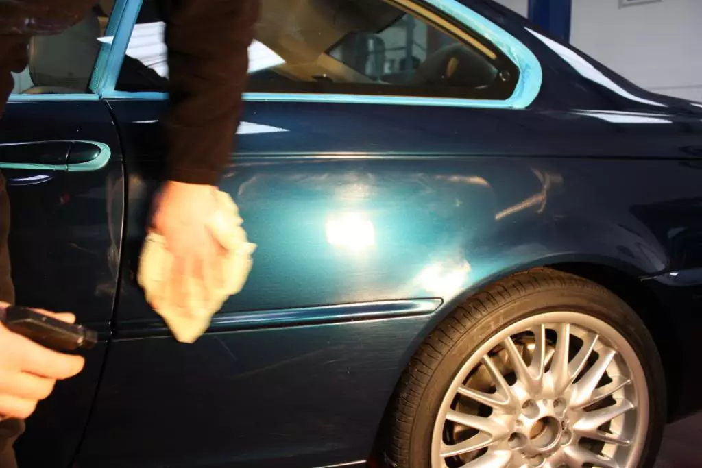

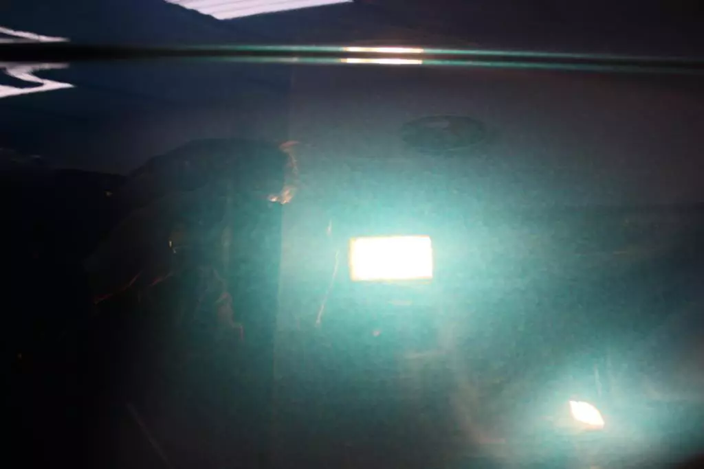

This then gets wiped down with a bodyshop final wipe style product.
After a wipedown, this is the result. It looks better - not worse!!! Holy Milwaukee, Batman... what is going on?

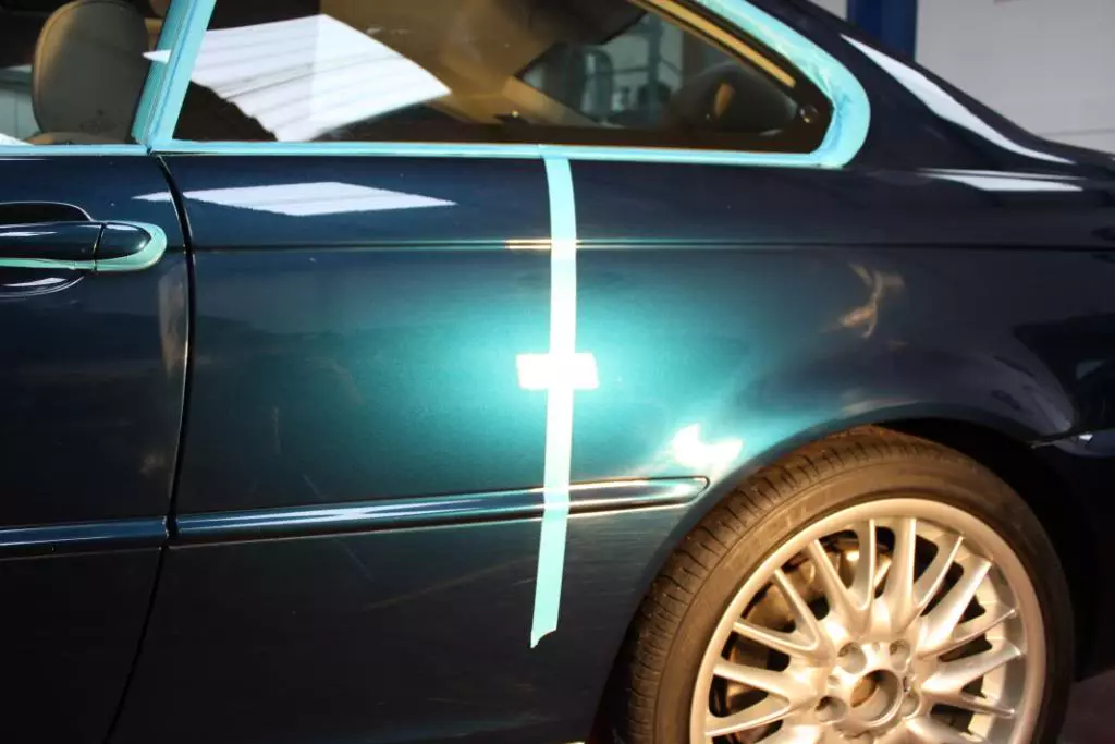

In the interests of fashion, erm, science, Kelly then masked off half the panel.

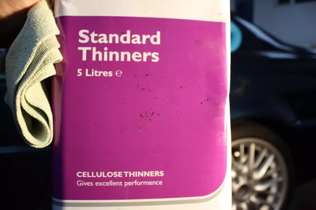

Out with the big guns... no messing with IPA.
You obviously need to be careful with solvents of this strength and volatility, they can soften or damage paint if used incorrectly. Light wipedown with heavy solvents, or heavy wipedown with light solvents is a fair guide.

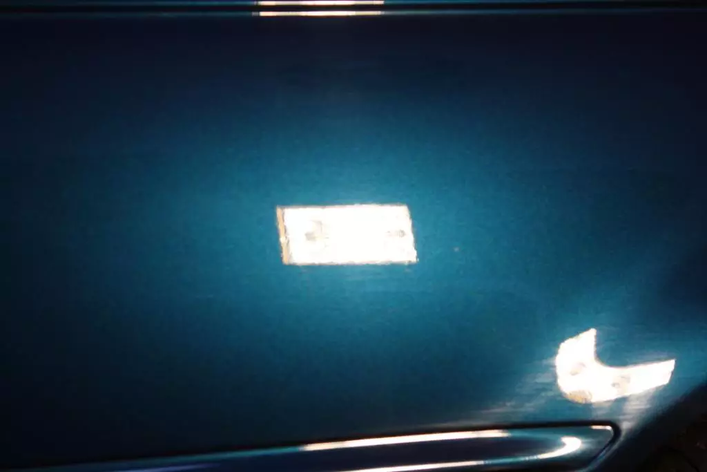

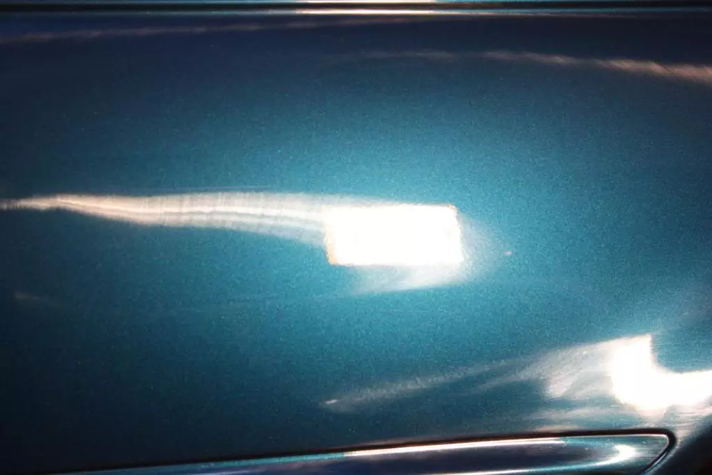

The result:
And from another angle...
Et voila... the underlying finish of the clearcoat is revealed, clearly visible to the naked eye. You may, of couse, get different results; different machining techniques, working times, clearcoat hardness etc.
